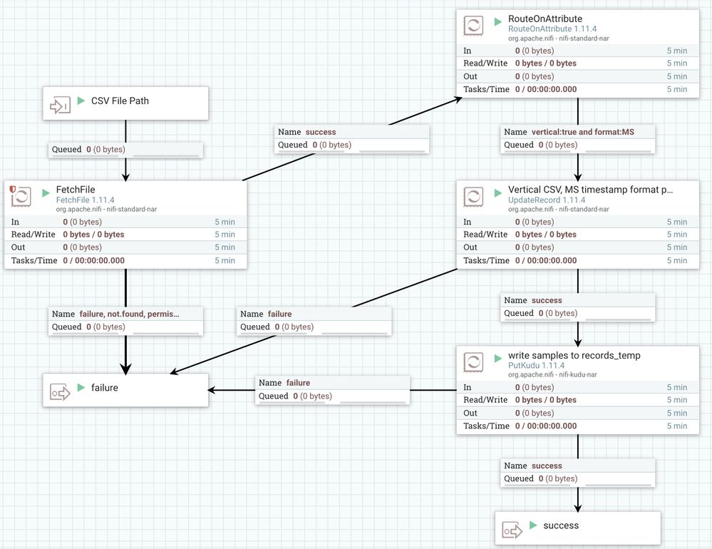

So the flow setup reads CSV file using FetchFile processor --> updates records values using UpdateRecord processor --> Writes values to Kudu using PutKudu processor.

So far the flow looks as follows:

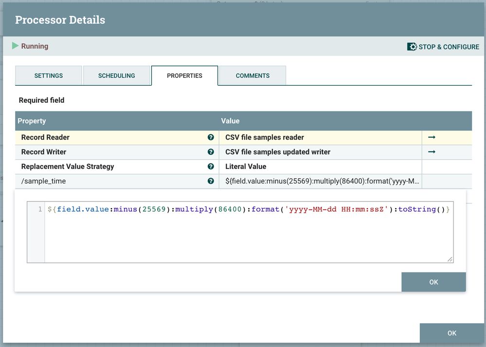

The UpdateRecord 1.11.4 processor defined as follows:
Where it mostly used to convert the sample_time value from Microsoft timestamp format (seconds since 31/12/1899) to yyyy-MM-dd HH:mm:ssZ ISO-8601 format.

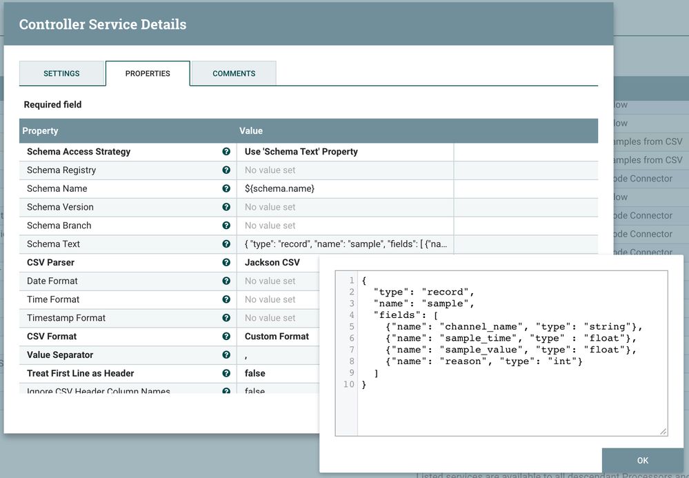

The CSV file samples reader (Record Reader) is defined as follows:

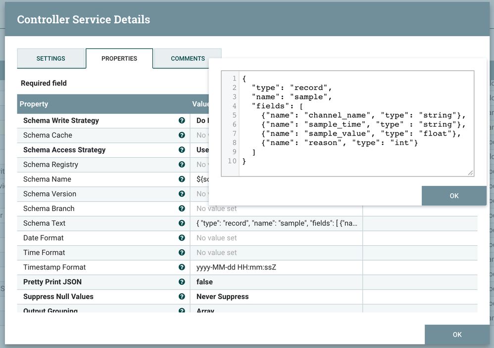

The Record Writer is defined as follows:

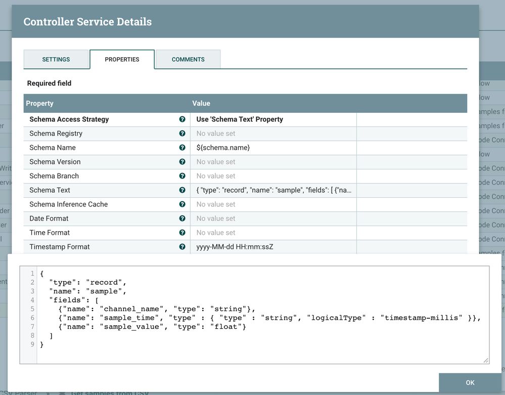

And finally the PutKudu Record Reader is defined as follows:
If the sample_time was not in as such complicated epoch format, I wouldn't need the UpdateRecord to convert the timestamp, as the last PutKude Records Reader service would do just that...

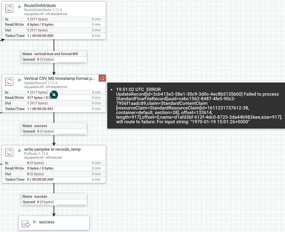

Anyhow, the flow returns the following failure, that I'm not sure how to handle it, and what's the problem with the output/input sample_time format:
If I understand correctly how the Record Reader/Writer schema works, it should process the sample_time in the following way: Get value from CSV as float format (using record reader) --> convert the value in any way using the UpdateRecord processor --> Write value in another format (string) using Record Writer...
How came this does not work?
