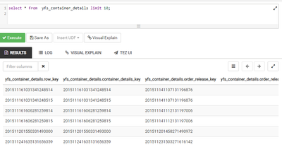

I've a Hbase mapped Hive table which retrieves rows when I run
select * from my_table;

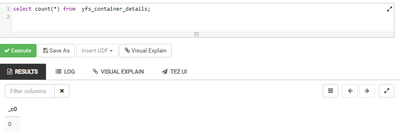

But when I execute
select count(*) from my_table;
the output is 0.
What must be the issue in this case ?

@Prathamesh H
Instead of select count(*) use
select count(<column_name>) from my_table;
this command will display number of rows in the hive-hbase table.
