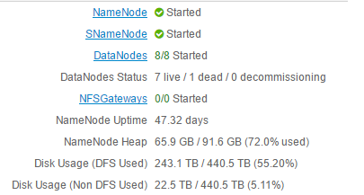

1) Check Data node is listing in Ambari WI
2) if data node is fine, it may be the jira as below.
https://issues.apache.org/jira/browse/HDFS-770
Expert Contributor
@zkfs Failed datanode is still listed in Ambari UI but there is a connection failed alert and running the hdfs dfsadmin -report command shows the dead datanodes.

Hello @Arpit Agarwal, the errors are quite frequent and I just restarted 2 data nodes now. Infact, 4 out of 8 data nodes have been restarted in the last 6 hours.
Just curious - why did you restart the Data Nodes? Did they crash?
Expert Contributor
Yes, the datanodes crashed @Arpit Agarwal. hdfs dfsadmin -report command is more accurate in reporting the datanode failure.
