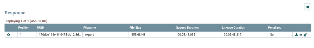

the InvokeHTTP response:
from the queue list:

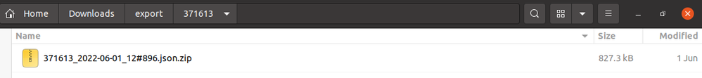

after I download:

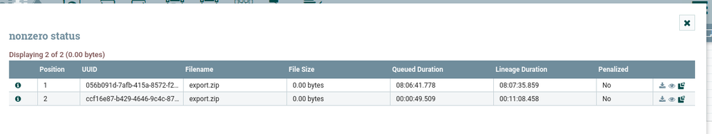

Now I have a flow file in the nonzero status queue from ExecuteStreamCommand as follows

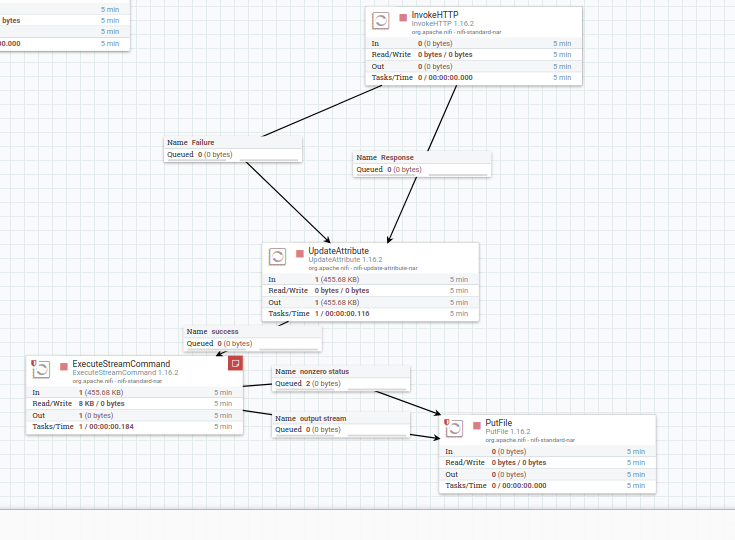

the whole cycle:
