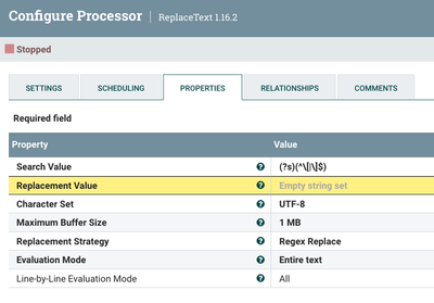

Super Guru
@baymax277 ,
Try this:
This is the regex:
(?s)(^\[|\]$)
You may have to increase the buffer size to accommodate your file.
Cheers,
André

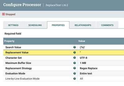

Super Guru
@baymax277 ,
The problem with your file is not the square brackets ([ ]). The issue is that single quotes are not a valid JSON quote. The correct JSON would be:
{"a":1,"b":2},
{"a":3,"b":4}
The content above is processed correctly by NiFi if you use record-based processors (like, for example QueryRecord).
Ideally your source data should be fixed to provide a valid JSON. For example, if those files are being generated by a Python script like this:
my_object = [{'a': 1, 'b': 2}, {'a': 3, 'b': 4}]
print(my_object)
The Python script should be updated to do this instead:
import json
print(json.dumps(my_object))
If you cannot have the source data fixed, you can try to replace the single quotes with double quotes using a ReplaceText processor with the following configuration.
This is a simplistic approach, though, and can cause problems in some complex JSON objects if you have strings with unexpected sequences of characters in them.
Cheers,
André
Was your question answered? Please take some time to click on "Accept as Solution" below this post.

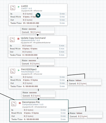

Explorer
@araujo
The jsons files are compressed and are placed in an S3 bucket. Here's the flow I have created to fetch s3 file and decompress it.

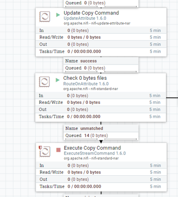

Explorer
I have not created that part of the flow yet, but that will be an ExecuteStreamCommand processor which will run a psql command with the copy sql query:
It will look something like this:
