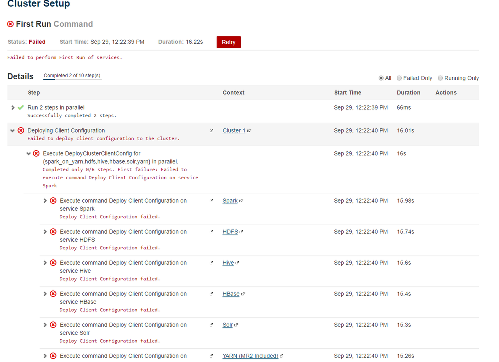

i tried to deploy Cloudera Cm in AWS faild
i think might be the clouder-scm dont have authorize so i follow the previous posted solution below .
Then i restart the machine to test . now i am not able to come to the autoconfig page .
1. How to restart autoconfig ?
2. If not able to restart autoconfig how to manually config the cluster ?
1.
ln -s YOUR_JAVA_HOME /usr/java/default
2. add sudo nopassword to cloudera-scm user
vim /etc/sudoers
cloudera-scm ALL=(ALL) NOPASSWD: ALL

i find out how to restart the config and check the log . In the log i find below error :
so i tried to curl the each node i started get Connection refuse error
Failed to connect to previous supervisor. Traceback (most recent call last): File "/usr/lib64/cmf/agent/build/env/lib/python2.7/site-packages/cmf-5.8.2-py2.7.egg/cmf/agent.py", line 2083, in find_or_start_supervisor self.configure_supervisor_clients() File "/usr/lib64/cmf/agent/build/env/lib/python2.7/site-packages/cmf-5.8.2-py2.7.egg/cmf/agent.py", line 2268, in configure_supervisor_clients supervisor_options.realize(args=["-c", os.path.join(self.supervisor_dir, "supervisord.conf")])

Created 10-08-2016 02:46 PM
thank you for your reply . after apply your suggestion i facing below error again.i find out someone said it is a bug but not impact running .Please help to give some input
ERROR org.apache.hadoop.hdfs.KeyProviderCache
[pool-4-thread-1]: Could not find uri with key [dfs.encryption.key.provider.uri] to create a keyProvider !!
