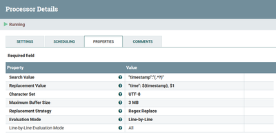

{"time": "THE_TIMESTAMP_VALUE/1000", "attribute a", "attribute_stuff_a", "event": $1}So I want to do a calculation based on a value found in the line-by-line and add a couple attributes. I've been able to do everything but add the calculated "time" value.
I tried separating the ExtractText and adding all the attributes in one and then adding the timestamp using the following ExtractText
