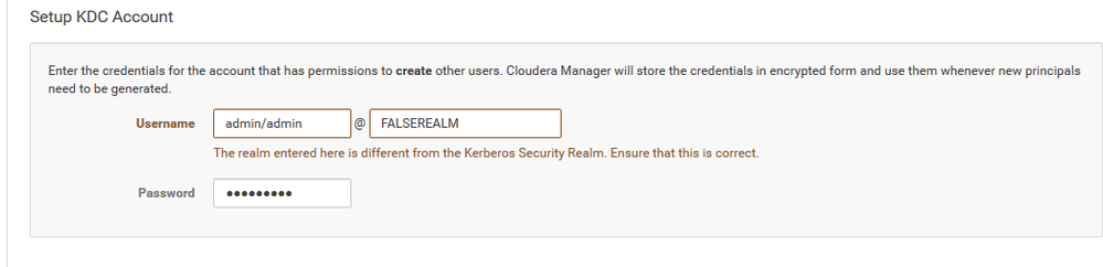

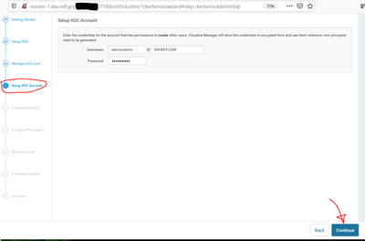

Anyway I still can't proceed with Cloudera kerberization because when I push (several times) the CONTINUE button in the right lower corner, which is enabled, nothing happens and the wizard remains on the Setup KDC Account page.
Here's a screenshot from the wizard where I try to click, even several times, but nothing happens.
I've tried with Mozilla, Edge, Chrome and IE browsers with no luck.
If I change the principal realm in the wizard, cloudera manager raises a warning (see below picture) and the CONTINUE button is disabled.
So it doesn't seem to be a Kerberos related issue.
Cloudera manager seems aware of Kerberos configuration.
