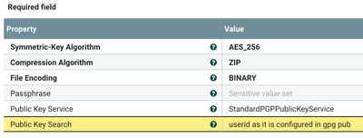

We configure nifi as follow:
When reading the same file in the flow, all goes well and we send the output to the next system. Which unfortunately fails to decrypt the file. They get an invalid key length error. So I checked the file size from nifi and looks like 394 bytes only.

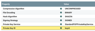

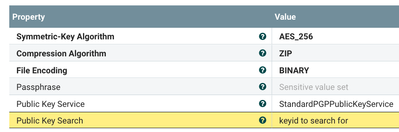

HI Matt, thanks for your reply and info shared. We did some changes, so now signing then encrypting the files:
signing
encrypting
When our next system tries to decrypt the file we get this error:
gpg: encrypted with unknown algorithm 183
gpg: decryption failed: Invalid cipher algorithm
Googling on this, encrypted with unknown algorithm 183, doesn't really give anything usefull.
