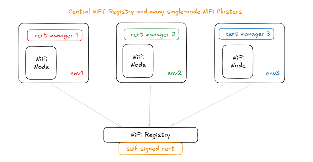

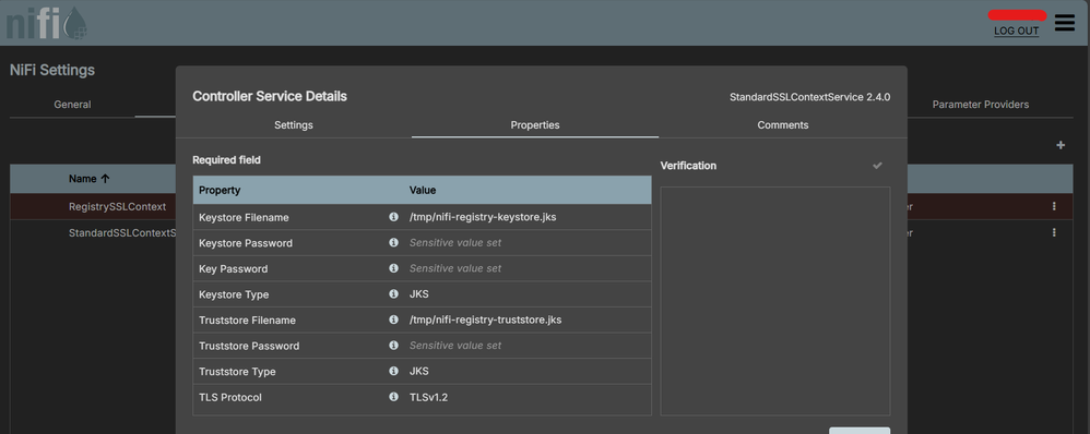

I'm on a single node nifi setup. As you suggested, I tried verifying my certificates the other way round i.e. NiFi Node's server certificates from my NiFi Registry. As expected, it didn't verify succesfully. As I had previously mentioned, my NiFi Nodes are being signed by cert manager and I'm using a self signed central nifi registry to connect from different single-node NiFi Clusters. I have attached an illustration of my setup below.
Since my NiFi Nodes are connecting from different environments and the fact that I use different cert-manager deployments to sign the certs for the respective Nodes, how can i connect to the registry without having to update the registry's truststore everytime I need to spin up a new nifi cluster in a new environment.
If I understand this correctly, the SSL context management controller is supposed to exactly solve this kind of problem right? The SSL Context in my NiFi Node(s) should contain the paths to the keystore and the truststore of my NiFi Registry, on the NiFi Node's local filesystem, isn't it? If I had multiple registries to connect to, I could simply similarly configure additional SSL Contexts for the respective registries in NiFi's management controller services isn't it? Please correct me if I'm wrong..

You are correct, The NiFiRegistry client should be using the keystore and truststore configured in the configured SSLContextService in the MutualTLS handshake with the target NiFi-Registry.
