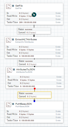

I'm doing HL7 parsing using ExtractHL7Attribute processor. My data flow looks like this -

@Ankit Jain In AttributesToJSON do you have the Destination property set to "flowfile-content"? If you don't then what it does is put the JSON in the JSONAttributes attribute and it leaves the FlowFile contents the same, in this case an HL7 document. An HL7 document of course isn't JSON and starts with MSH, so this is the error you'd see if you have Destination set to "flowfile-attribute" (the default) and not "flowfile-content".

Thanks It worked when I changed it to "flowfile-content".

In AttributesToJson, is the destination set as flow file content or flow file attribute?
It would need be set as flow file content for it to work with PutHBaseJson.
