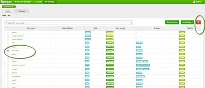

Go to ranger admin page.
Click on settings.
Select Users
select user to delete.
Hit the red delete button
You should know the next time sync is ran the user will show up in list. If you want to remove user permanantly I recommend you remove user from the OU group in AD/LDAP.
