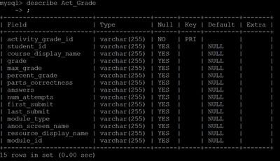

When i execute this command
sqoop export --connect jdbc:mysql://127.0.0.1/mooc2015 -m 1 --driver com.mysql.jdbc.Driver --table Act_Grade --export-dir /apps/hive/warehouse/hactivitygrade --input-fields-terminated-by '\0001'
I got following error

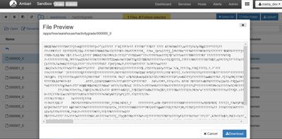

@Br Hmedna You are trying to export ORC data into mysql without converting it to text. You should use sqoop hive export to do this. Look at this link https://community.hortonworks.com/questions/22425/sqoop-export-from-hive-table-specifying-delimiters...

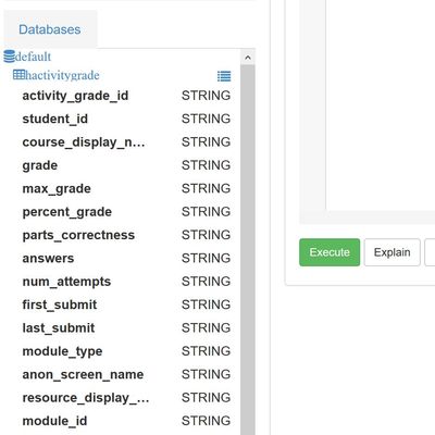

Couple of things, from screen shot your data is in ORC format.
to import and export use HCatalog integration,
the syntax for the export would be
sqoop export --connect jdbc:mysql://127.0.0.1/mooc2015  –username <mysql_User> –password <mysql_pwd> –table Act_Grade –hcatalog-table <hive_table> --hcatalog-database <hive_database_name>
please note that --export-dir option is not supported while on hcat integration, so better use above syntax.
