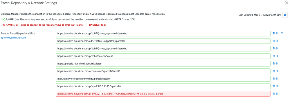

Hi all, I have installed CDP 7.1.8 runtime and CM 7.7.1. When I would like to download the parcel for CFM, I got the error shown below
On my VM, I can download the parcel using wget, so I don't know why it shows 404 not found.
Please kindly help me out, thanks in advance.

Hi @BrianChan ,
In the screenshot, we could see that you have added CFM Parcel instead please add the parcel directory like below and try once:
https://archive.cloudera.com/p/cfm2/2.1.5.0/redhat7/yum/tars/parcel/

Contributor
Hi @BrianChan ,

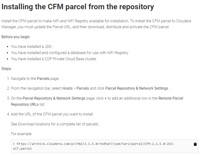

@pkr , Thanks a lot, seems the system can reach the link you provided.
Seems the documentation is a bit misleading? As I directly copy what shows on the web page.
