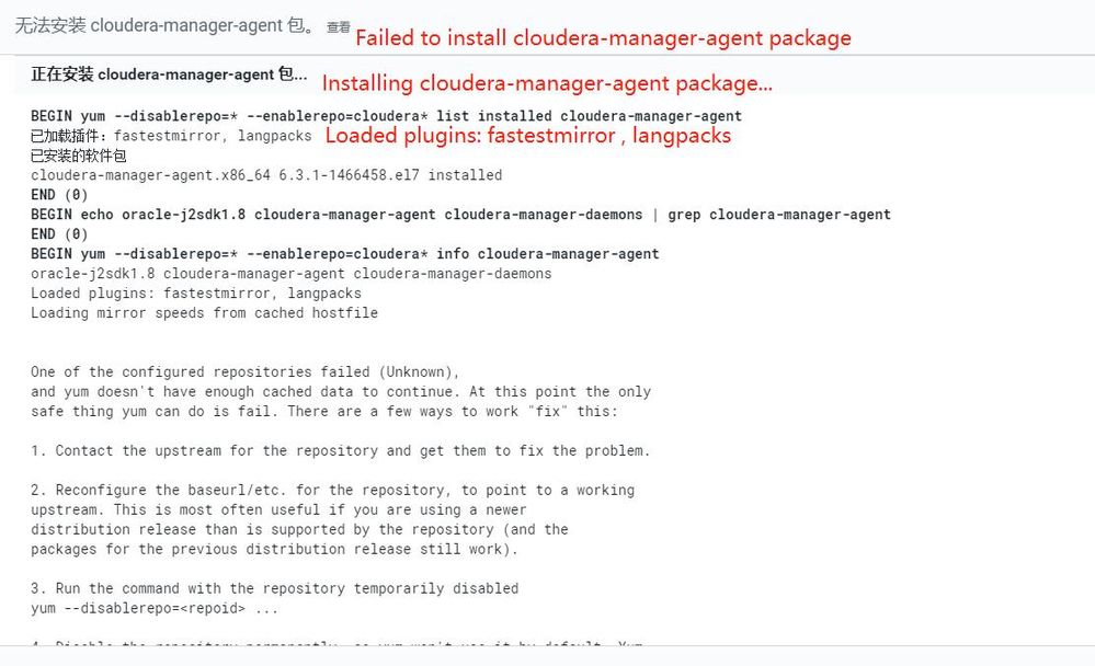

I am trying to install cloudera-manager offline and the above problem occurs when I install cloudera-manager-agent package.
微信图片_20220926155347.jpg微信图片_20220926155347.jpgInstalling cloudera-manager-agent packs...

@Laplace it seems like the cloudera manager repo you are using on that server is not correct, please check the repo and correct it, it could be the URLs present are incorrect.
repo path: /etc/yum.repos.d/
