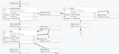

Regardless of how you retrieve the files, you are looking for a way to only process those files where you also retrieved the corresponding sha256 file. This can be accomplished using the Wait and Notify processors:
In the above flow I have all the retrieved data (both <datafile> and <datafile>.sha256 files) coming in to a RouteOnAttribute processor. I route all the <datafile>.sha256 FlowFiles to a Notify processor. (in my test I had 20 <datafile> files and only 16 corresponding <datafile>.sha256 files). The Notify processor is configured to write the ${filename} to a DistributeMapCache service that every node in my cluster can access. My Wait processor is then designed to check that same DistributedMapCache service looking for "${filename}.sha256". If a match is found the Wait processor will release the <datafile> to the success relationship for further processing in your dataflow. The Wait processor is also configured to wait on so long looking for a match. So you see in my example that after the length of time the 4 Flowfiles that did not have a matching sha256 filename in the cache were routed to "expired" relationship. Set expiration high enough to allot for the time needed to retrieve both files.

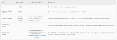

The DistributedMapCacheServer provides the following configurations:
There is no TTL for the DistributedMapCacheServer option.
