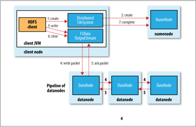

  4. For the put command, only HDFS is involved. Without going into details : the client asks the NameNode to create a new file in the NameSpace. The NameNode do some checks (file doesn't exists, user have right to write in the directory, etc) and allow the client to write data. At this time, the new file have no data blocks. Then the client starts writing data in blocks. For writing blocks, the HDFS API exchanges with the NameNode to get a list of DataNode on which it can write each block. The number of dataNodes depends on the replication factor and the list is ordered by distance from the client. When NameNode gives the DataNodes list, the API write a data block to the first node, which replicates the same block to the next one and so on. Here's a picture from The Hadoop Definitive Guide that explains this process.
