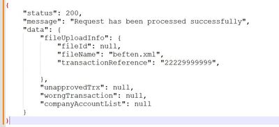

I am using apache nifi. I have called first InvokeHTTP which provides json response. From json response, I need transactionReference and post another InvokeHTTP using transactionReference with some other value using jsonbody request. Here is the  first InvokeHTTP json response:

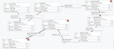

I have tried below like diagram:
Flow is: Getfile->UpdateAttribute->InvokeHttp->EvaluateJsonPath->UpdateAtribute ->AttributeToJson->InvokeHTTP

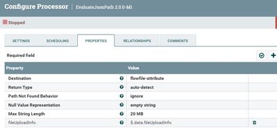

Here is Screen shot start from EvaluateJsonPath :

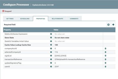

UpdateAtribute

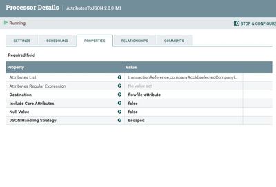

AttributeToJson:

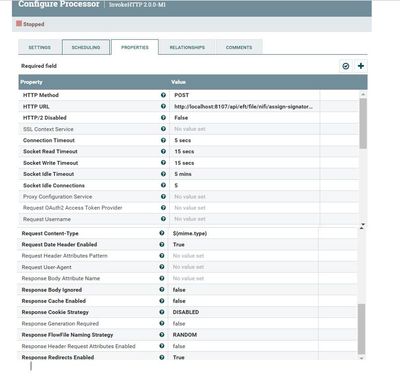

InvokeHTTP
My request json not updated. I got first json response. That means I got first invokeHTTP response  when I called second invokeHTTP .

@enam   I cant see the entire configuration of the second InvokeHTTP so I am not sure if you are passing those new attributes into the HTTP URL.   If you are not doing that, I think the solution you are looking for is to have the AttributesToJson set Destination to FlowFile Content.  Then when you post that to invokeHttp,  those values are seen as the post content.
