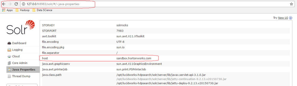

I have spinned up solr through Ambari and Nifi is installed on hortonworks sandbox. When I added processor "putsolrcontentstream" it gave me an error "IOException occured when talking to server at: http://sandbox.hortonworks.com:8983/solr/tweets_shard1_replica1". My guess is that Nifi is trying to connect to http://sandbox.hortonworks.com:8983/solr/tweets_shard1_replica1 whereas tweets_shard1_replical is in below address and i can see it in my browser http://127.0.0.1:8983/solr/tweets_shard1_replica1
I checked on solr UI --> Java properties that HOST is given as sandbox.hortonworks.com and ZKHOST is given as sandbox.hortonworks.com:2181/solr
QUESTION: How to replace and where to replace sandbox.hortonworks.com with 127.0.0.1 so that I no longer get error on putsolrcontentstream processor on nifi. Attached are relevant screenshots for reference purpose. Please help.

Did you add the collection name to the properties in the PutSolrContentStream processor? what are the other properties you have in there?
