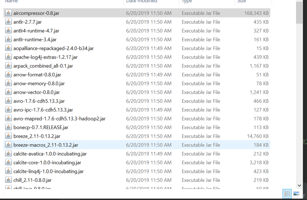

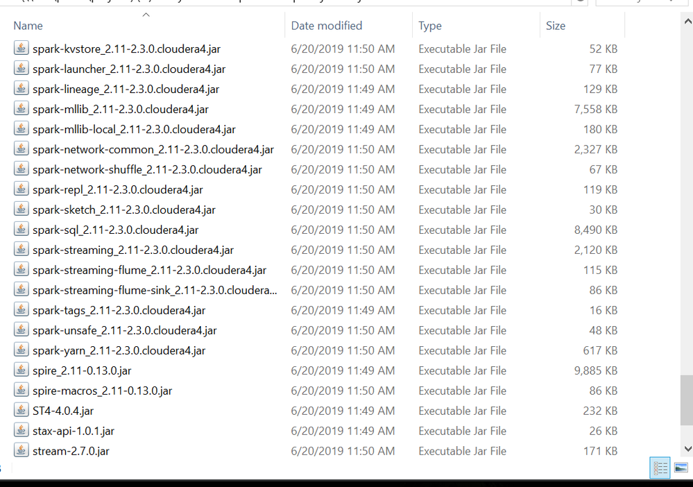

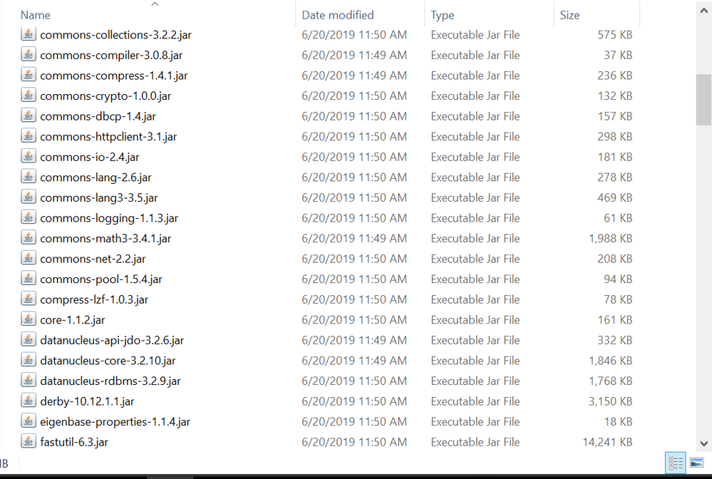

I imagine it has to with not having the jar file SparkConf, I'm using IntelliJ for this project and I've added some jars to my project, I've taken some screen shots of what the jar files look like and have attached them to the post. Curious if any of these jars look familiar to anyone, I may not even be adding the right ones.
