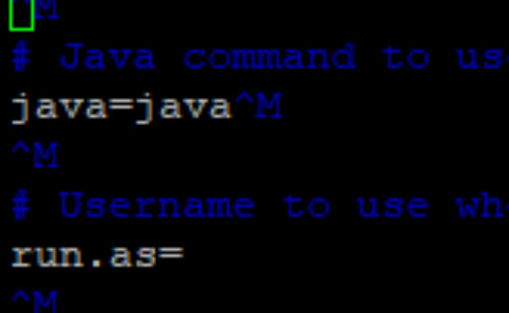

Find out the problem.
It seems that in versions above 1.14 the bootstrap.conf file has an option in the ^M file
where you can change the file parameters
I removed this option in the value "Run.as"
and the problem was solved
