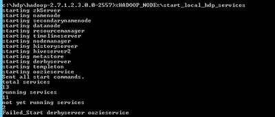

I'm a newbie in this field and trying to setup HDP 2.3.0 single node cluster on a Windows Server 2012 R2 system. I've been following the steps mentioned here: http://docs.hortonworks.com/HDPDocuments/HDP2/HDP-2.3.0-Win/bk_QuickStart_HDPWin/content/ch_qinst.ht...
However, after successfully installing HDP 2.3.0 as per instructions, I was able to start the services with 2 failures:2134-hdperr1.png

@Aditya Goyal this seems to be a common problem, can you retry your install with SQL server and not derby. People are having issues with derby on windows.

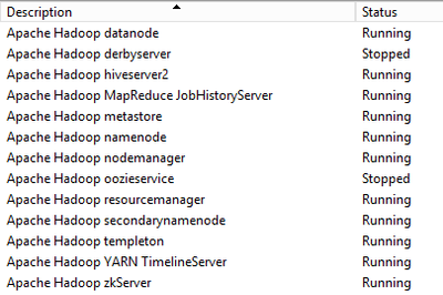

@Rahul Pathak
1. Please see the below snapshot status of services running:2138-hdperr3.png

Master Mentor
@Aditya Goyal
As reiterated in my earlier posting the reason is the derby database is down.
Start you DB so that Oozie can load it's config also see oozie config
New Member
Hi @Geoffrey Shelton Okot, the derby database stops immediately whenever I try to start it.
Master Mentor
New Member
Thanks @Artem Ervits, SQL server solved the problem. 🙂
