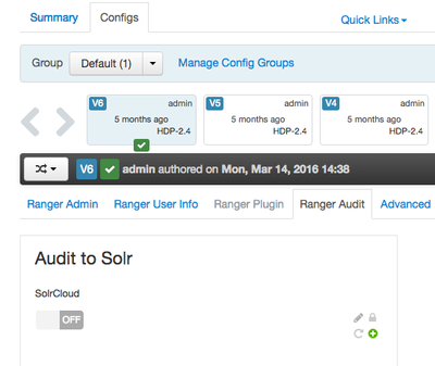

Hi @Avijeet Dash - audit to Solr is now enabled by default. You can go into Ranger Configs in Ambari and disable it using the slider button as in the screenshot below:
