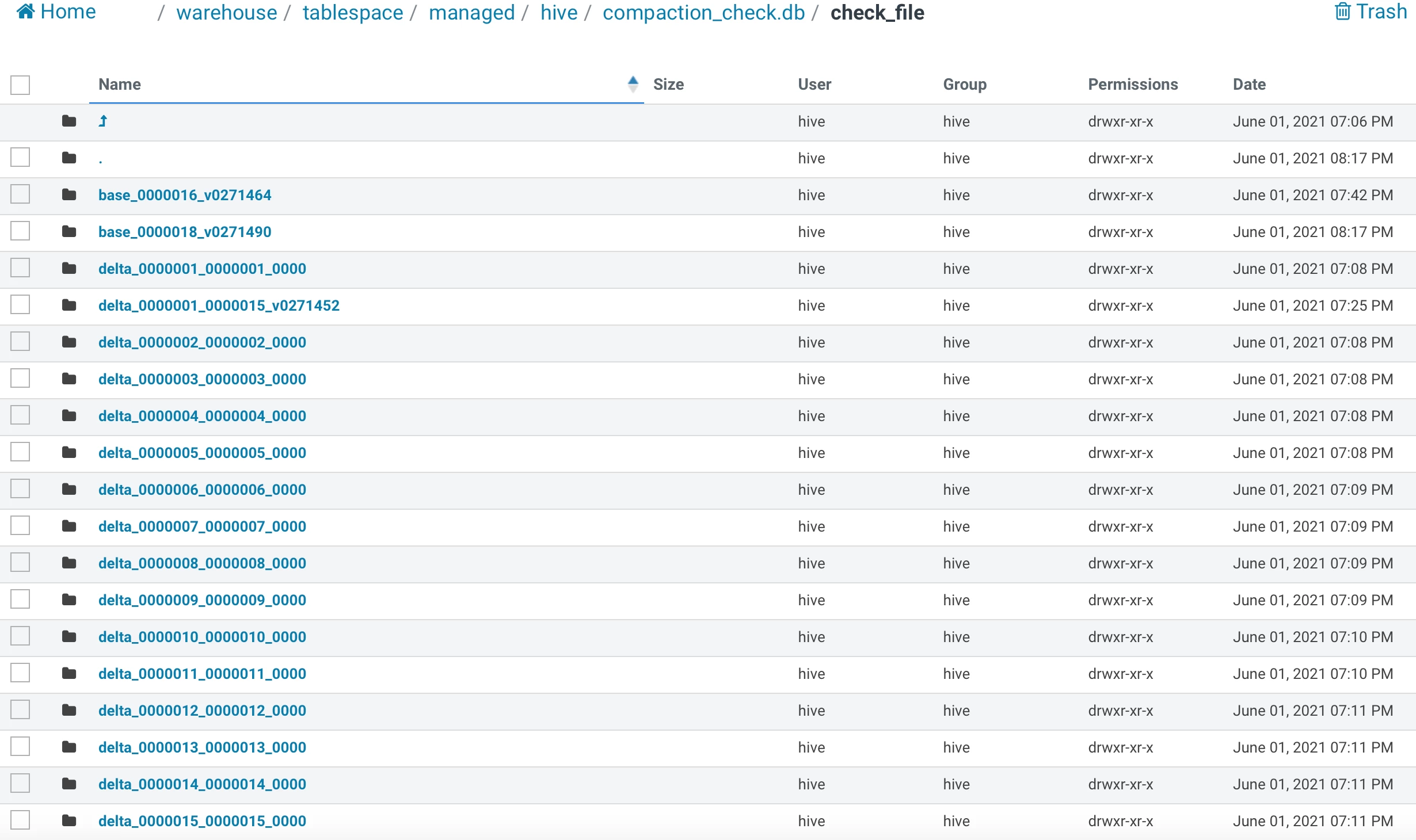

I have run manually minor and major compaction. Table data is referring to the new delta and base folder but the old delta and base folders are not removing and it consumes the hive storage. Moreover, No running job is referring to this table.

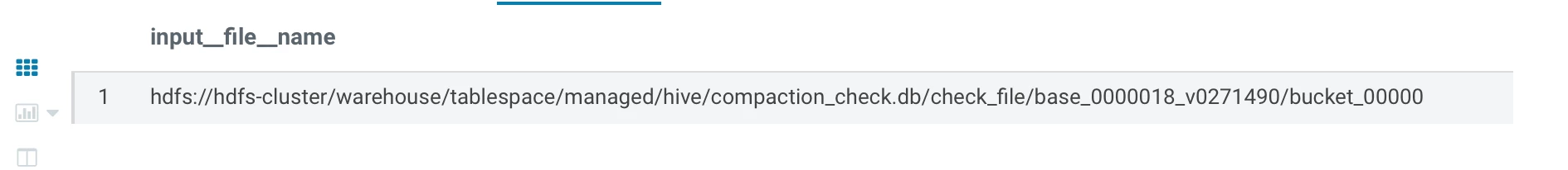

Check input files:
select distinct INPUT__FILE__NAME FROM compaction_check.check_file;
output:
Actual table directory :
Why stale the base and delta folders are not removed?
