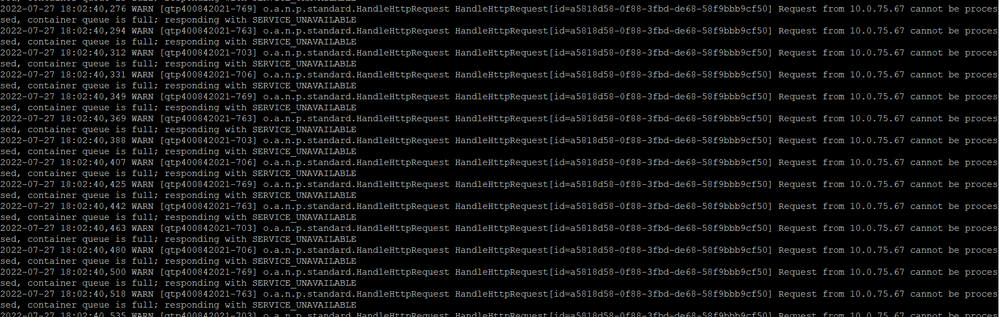

While running a load test suddenly HandleHttpRequests stopped emitting flowfiles recieved and started throwing error show in below image -
So we stopped the load test and now even after 30 mins when we send requests it will just emit 2 or 3 flow files and again shows same error and does not release/emit any request flowfiles.

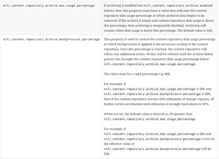

You may also want to look at your content repository settings for:
Compare those to your disk usage where your content_repo is located.
https://nifi.apache.org/docs/nifi-docs/html/administration-guide.html#content-repository
