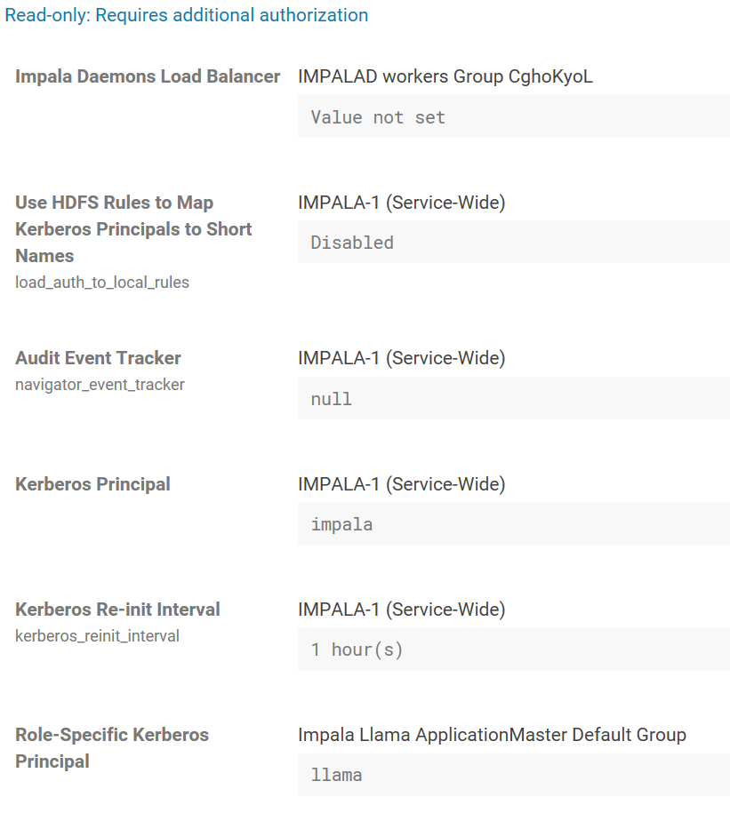

These are the relevant properties I found on the Cloudera Manager (read only access) for Impala and Kerberos:

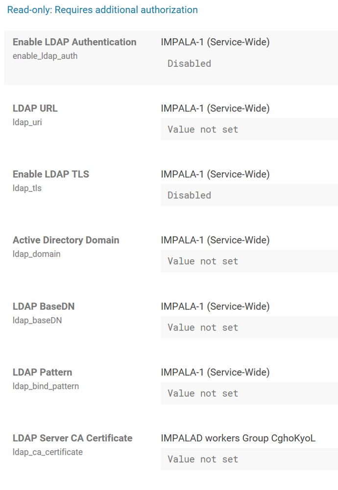

I am trying Kerberos authentication because it seems LDAP authentication is disabled for Impala:
