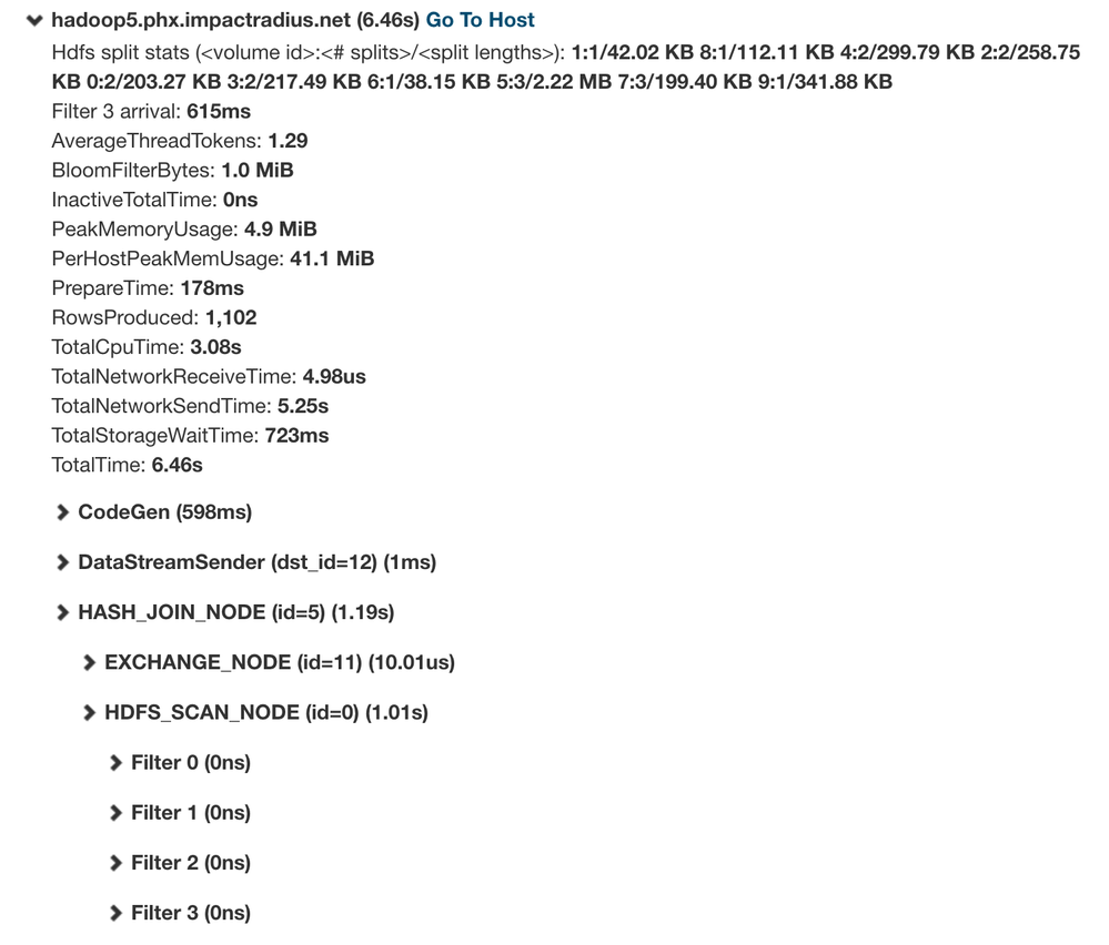

Hello everyone, trying to hunt down some slow query times here.
Focusing on just one type of query, it normally runs in about 1 second, but about 1/3 of the time it takes 6 or even 8 seconds.  Looking at the profile of a slow run, hdfs scans are super fast (under 1 second and usually closer to 400ms) in all 22 nodes, as expected, because we're partition pruning aggresively and using hdfs caching, HOWEVER the entire 00 fragment takes a whole 6 seconds, most of it in TotalNetworkSendTime.
How can I know what send time to which other plan node is the culprit, since this node (00) seems to be connected to all other nodes in the plan (query has 4 inner joins)?
Using CDH 5.7   Happy to send entire profile directly, but don't want to post publicly.
Thanks in advance!
-m

We could definitely improve some of the diagnostics there. My guess is that one node is either overloaded or has some kind of hardware issue - might be worth looking at the health and CPU/memory usage of different nodes to see if one stands out.

Re: Help diagnosing slow query (even though fast hdfs scan)
One thing to keep in mind when interpreting the profiles is that a series of joins will typically be pipelined to avoid materialising results. This means that the whole pipeline runs at the speed of the slowest part of the pipeline. So the limiting factor could be the client (if you're returning a lot of results), the scan at the bottom of the plan, or any of the joins in the pipeline.
TotalNetworkSendTime may be somewhat misleading since if the sender is running faster than the receiver, a backpressure mechanism kicks in that blocks the sender until the receiver has caught up.
What's I'd recommend initially is comparing query summaries of the fast and slow queries to see where the difference in time is.

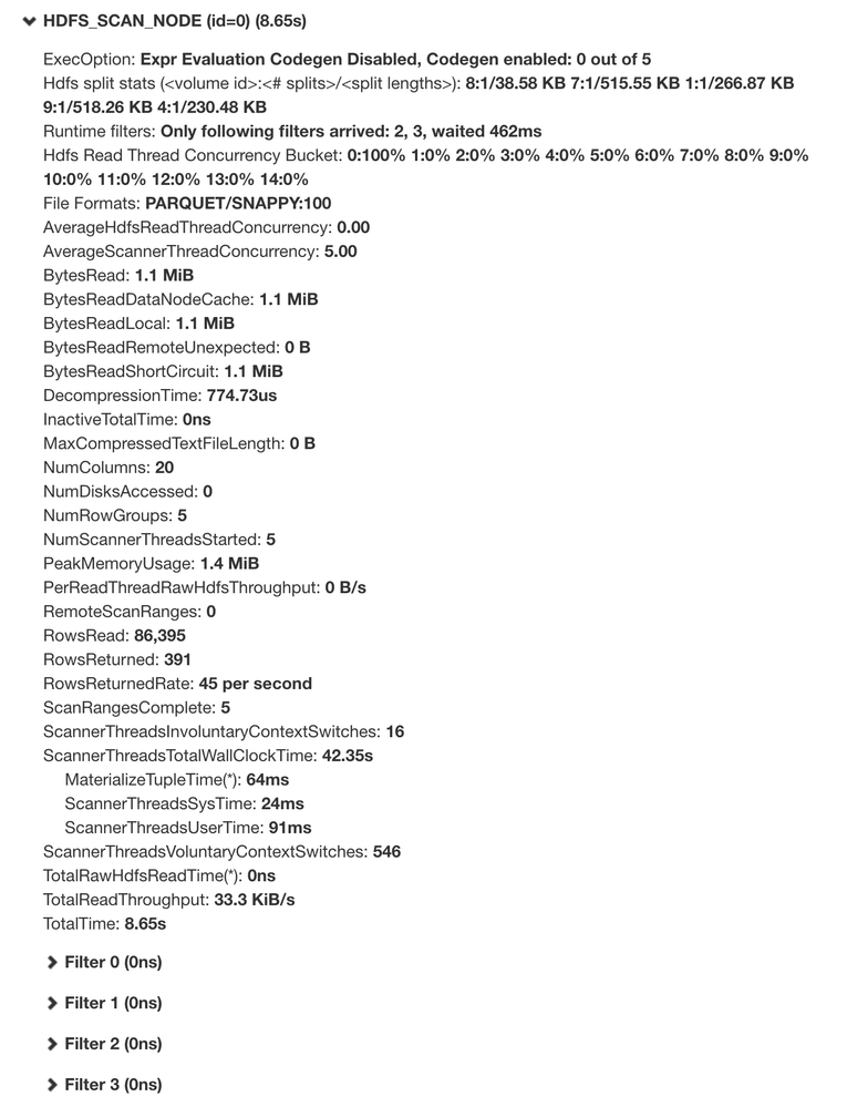

Quick follow up question (last one promise), here's another weird instance of that same query which happens often: relatively small (by comparison) hdfs scan of 1MB and 86K rows, all local, all from cache, and still took 8 seconds vs. about the normal 400ms in all other nodes.  Since disk is not a factor here, what else could be holding up the read from cache? cluster is barely loaded at 20% cpu.
Please do open a JIRA - it's always good to have some context on the problem from users.
It looks like the scanners in that profile are just idle (based on the user and system time)  - so my guess is that the slowdown is something further up on the plan.
