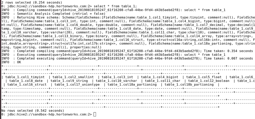

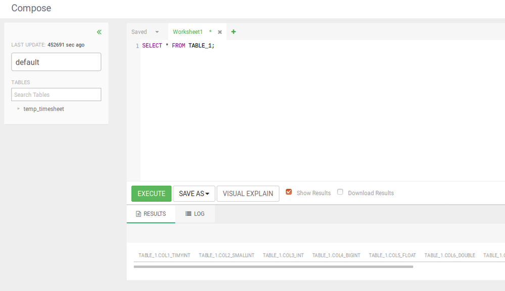

I am facing an issue:
hive table created in data analytics studio is not listed under tables (refer below screen print, tables listed under "Search Tables" text box)
But when doing select that table is shown in results (refer below screen print, under results)
Could you please let me know what is the issue here and how it can be corrected.

Master Mentor
@shashank_naresh @KWiseman
I have responded to this issue before can you have a look at the thread
https://community.cloudera.com/t5/Support-Questions/DAS-Database-Empty/m-p/238223#M200034
Please let me know if you need more clarification, I have attached 2 pdf's to walk you through the solution.
Happy hadooping
