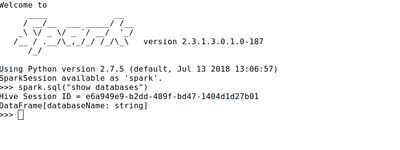

Hi,
I am trying to run spark application which will need access to Hive databases. But Hive databases like FOODMART are not visible in spark session.
I did spark.sql("show databases").show(); it is not showing Foodmart database, though spark session is having enableHiveSupport.

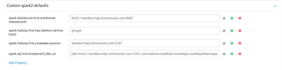

Hi @dbompart,
Thanks for the answer,
I am using HDP3.1,
I've tried to change the settings per link "https://docs.hortonworks.com/HDPDocuments/HDP3/HDP-3.1.0/integrating-hive/content/hive_configure_a_s..."
2) Trying to get hive databases in spark - no success;

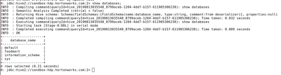

3) Can see hive databases in hive
Could you please assist me on this, what else needs to be done.

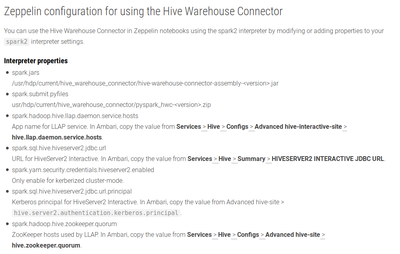

1) Changed the Zeppelin setting per below
2) Restarted notebook
3) Tried below code in notebook and getting below import error.
Requesting to assist here.
Thanks and Regards.
Contributor
Zeppelin and Spark-shell are not the same client and properties work diferently, if you moved on to Zeppelin can we assume it did work for Spark-shell?
In regard to the Zeppelin issue, the problem should be within the the path to the hive warehouse connector file either on the spark.jars or the spark.submit.pyFiles, I believe the path must be whitelisted in Zeppelin, but its clear that the hivewarehouseconnector files are not being succesfully uploaded to the application classpath, therefore, the pyspark_llap module cannot be imported. Hope it helps.
