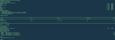

@li michaelCan you install python-argparse as below..
yum install python-argparse
You should see console output with success messages like below

@Ayub PathanI executed the yum install python-argparse command, the results failed, showing No package python-argparse available.(I first install setuptools, and then install the PIP, through the PIP installed argparse, the implementation of the command is python setup.py install .) below is a screenshot

@Ayub PathanCentOS 6.6 without a argparse module, can you describe the specific steps you have installed the argparse module?Thank you !

@li michael Looks like you have yum repo enabled that points to your local file path(file://mnt/cdrom/repodata/repmd.xml).
To fix this, make sure to set "enabled=0" in /etc/yum.repos.d/CentOS-Media.repo on your machine and have a working internet connectivity.
cat /etc/yum.repos.d/CentOS-Media.repo # CentOS-Media.repo # # This repo can be used with mounted DVD media, verify the mount point for # CentOS-6. You can use this repo and yum to install items directly off the # DVD ISO that we release. # # To use this repo, put in your DVD and use it with the other repos too: # yum --enablerepo=c6-media [command] # # or for ONLY the media repo, do this: # # yum --disablerepo=\* --enablerepo=c6-media [command] [c6-media] name=CentOS-$releasever - Media baseurl=file:///media/CentOS/ file:///media/cdrom/ file:///media/cdrecorder/ gpgcheck=1 enabled=0 gpgkey=file:///etc/pki/rpm-gpg/RPM-GPG-KEY-CentOS-6
Basically this setting "enabled=1" is used when there is no internet connectivity and you want to read all repo data from your local machine.
Hope this helps.
