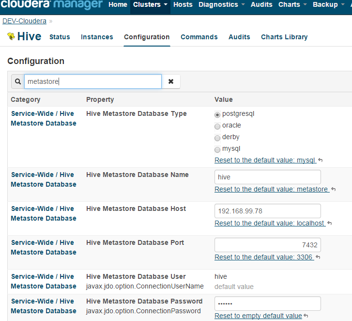

Also, the source of the issue is not reling in the derby metastore since the metastore database is not the default one. I'm mentioning this, because of the stackoverflow post: http://stackoverflow.com/questions/23615309/oozie-with-hive-issue
