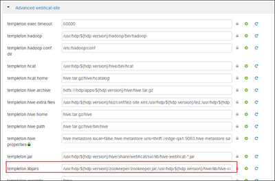

However regarding the "templeton.libjars" jar issue "/usr/hdp/${hdp.version}/zookeeper/zookeeper.jar,/usr/hdp/${hdp.version}/hive/lib/hive-common.jar" i have seen some environments where after upgrade when we fix the "templeton.libjars" path then the issue gets resolved.
- Can you please double check if you have mode the correct changed to it inside the "Hive" ==> "config" ==> "Advanced" ==> "Advanced webhcat-site" config?
- After that you will need to restart the services that requires restart (including the "webhcat").

The mysql error isn't gone - the mysql-connector-java.jar file is gone ! I copied it to the /usr/hdp/current/hive-server2/lib path but after restarting the Hive service - the file is gone! It is as if it is being deleted by the restart itself . Look at the screenshot of before and after (The shell in which i did "ll | grep mysql") - it's there, and after restarting - it's not there anymore. The file is gone. Vanished. Disappeared. Regarding the templeton.libjars here is the screenshot after the fix:
