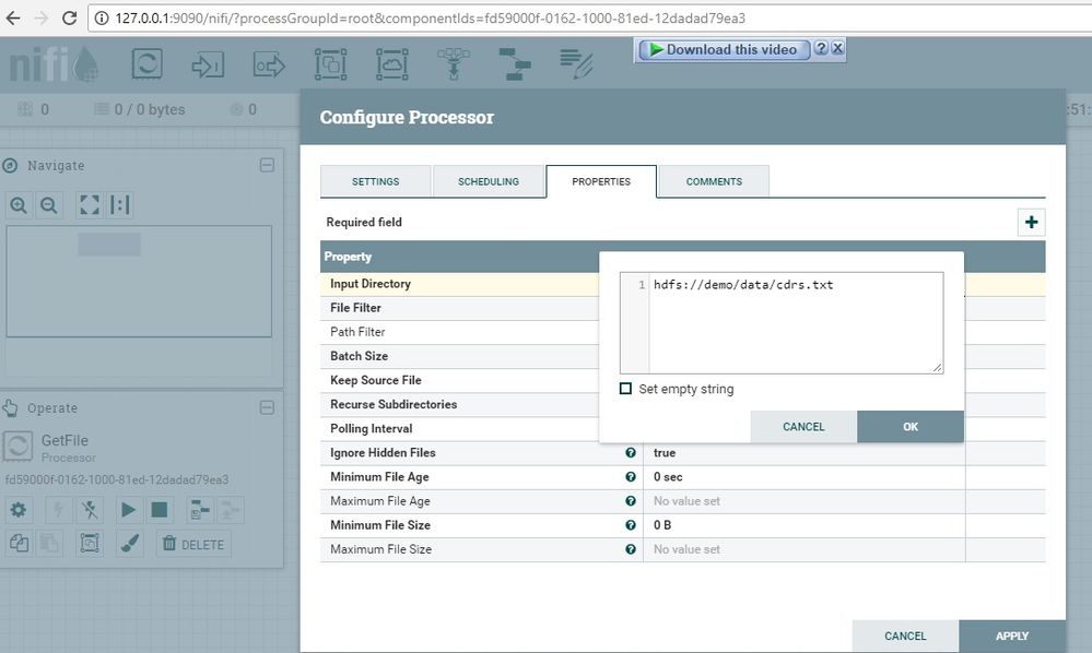

How i can set getFile Path for Nifi. it is giving me error as i mentioned in picture. Please help. Thanks in Advance.

@Atif Tariq
Case1:-
If your file is in local filesystem then you can use get file processor
Input Directory
/demo/data
File Filter
cdrs.txt
Keep Source File
false //if set to false delete the file after fetch,if true don't delete the file
Case2:-
If your file is in Hadoop File system(HDFS) then you need to use GetHDFS processor to pull the file from Hdfs to NiFi.
If you are using kerberos then you need to specify principal and keytab values in the properties.
Hadoop Configuration Resources
<path to core-site.xml,hdfs-site.xml> //we need to provide the file path for core-site.xml,hdfs-site.xml here
Directory
/demo/data
Keep Source File
File Filter Regex
cdrs.txt
Let us know if you are having facing issues..!!

Right Said, Thank you so so so much. you saved my lot of efforts.
