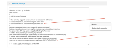

How do you reduce the level of logging for YARN?
1 ACCEPTED SOLUTION
Change the yarn-log4j configuration as shown. Make sure that the properties are uncommented.
2 REPLIES 2
Add the following variable to the yarn-log4j configuration via Ambari
export YARN_ROOT_LOGGER=DEBUG,RFA
Be careful, this will fill up the Resourcemanager log with a lot of details 🙂
