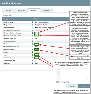

In my NiFi project I get messages one at a time. I convert these into AVRO and, as one followup step, I want to bin them up into ORC files for use with Hive. To that end, I would like to use a MergeContent processor. Is that a good approach? How to find the correct configuration?

You may want to try merging your CSV files before sending them to the ConvertCSVtoAvro processor. Try configuring your MergeContent as follows:
Feed merged output from this processor to the ConvertCSVtoAvro, then that output to ConvertAvroToORC processor, and finally off to hive.

What format are your original messages in before you convert them to Avro?
Not applicable
Original format is CSV.
Master Mentor
@Hellmar Becker
Thanks,
Matt
Not applicable
Thanks, this works great! Still I wonder: can I force NiFi to create larger batches? I noticed that whenever the batch size exceeds the queue size, things get stuck.
