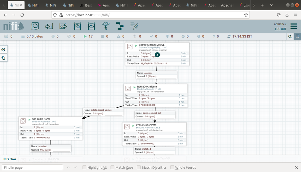

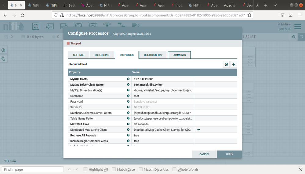

Below is my current configuration screenshot to read the data from single instant connecting two source DB.

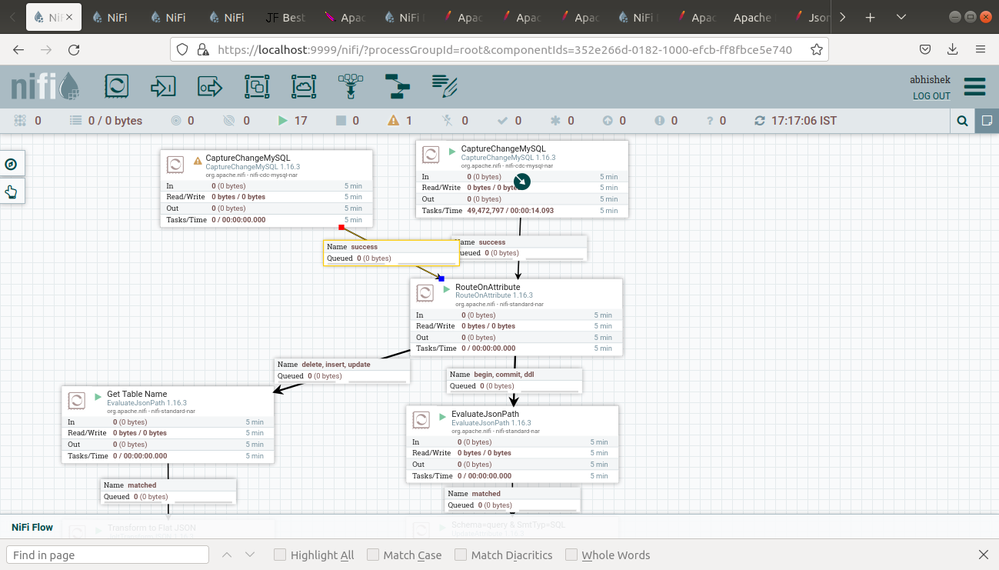

Are you suggesting to create two flow-file templates with respect to MySQL database service?
Or This can be achieve by just using the the two CaptureChangeMySQL Processors in one template which will have the configuration with respect to MySQL database service.
Attaching the current flow-file screenshot and also as per you suggestion with two captureChangeMySql processor. Please confirm If my understanding is correct as per you suggestion

I mean you can have as many CaptureChangeMySQL for a number of different MySQL DB's , Yes your design is alinged with what I have updated before.
