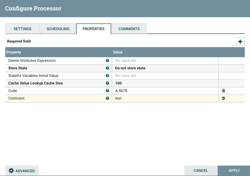

1. Yes, sorry for some reason they didnt get saved in that version of the template. I will update. You should see or set it like this:

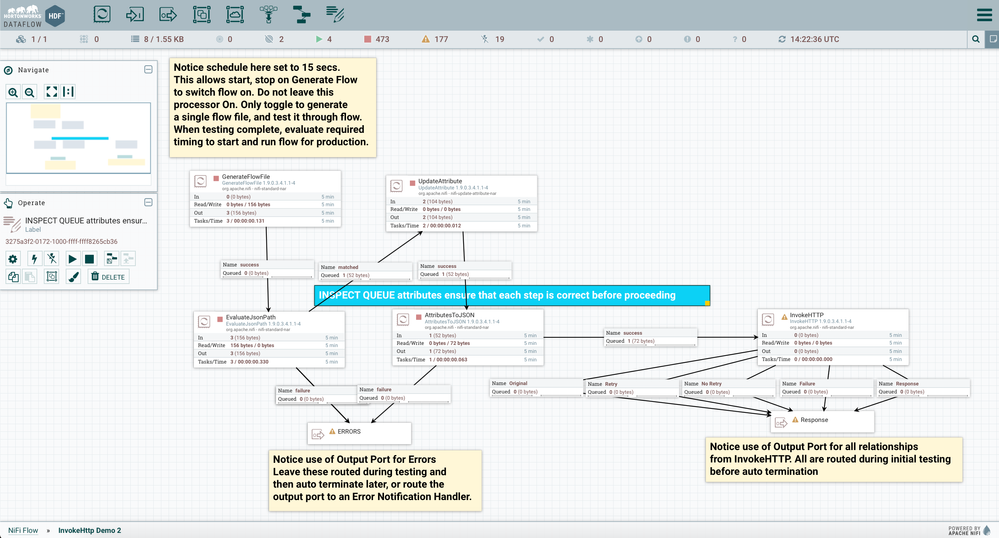

@vikrant_kumar24 To add new attributes to a flow file you should use UpdateAttribute. To get attributes from json you should use EvaluateJsonPath. Once you have all the values you want as attributes you should use AttributesToJson and then finally send the json to invokeHttp.
Your flow will look like this:

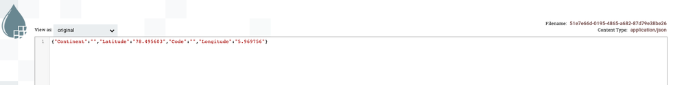

And the Queued Flowfile waiting on InvokeHttp is:
Please note I did not have your original Json, just the schema above, so I created a simple JSON of the Longitute & Latitude values you gave me. I also did not touch InvokeHttp, its default. Once you get this far, and want to work on handling the response from InvokeHttp let me know here, in another post, or a private message. To see my entire template, check out my GitHub for the Invoke Http Demo 2 Template:
