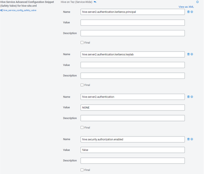

Hive Service Advanced Configuration Snippet (Safety Valve) for hive-site.xml
hive.server2.authentication.kerberos.principal
hive.server2.authentication.kerberos.keytab
hive.server2.authentication NONE

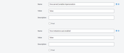

hive.security.authorization.enabled false
hive.server2.enable.impersonation false
hive.metastore.sasl.enabled false

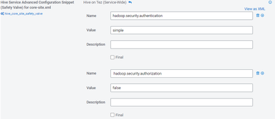

Hive Service Advanced Configuration Snippet (Safety Valve) for core-site.xml
hadoop.security.authentication simple
hadoop.security.authorization false

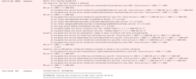

After turning off the following parameters and restarting HiveServer2, we noticed that HiveServer2 still seems to fail due to Kerberos authentication.
