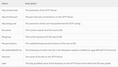

You can use the ListSFTP processor to list all files on your SFTP server. The ListSFTP processor will create a 0 byte file with the following additional attributes written to it:

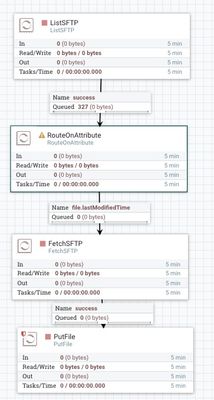

Take the success relationship of the ListSFTP and send it to a routeOnAttribute processor.
Use the routeOnAttribute processor to route on those FlowFiles where the attribute "file.lastModifiedTime" date falls within your desired range to a FetchSFTP processor. All other listed files could just be auto-terminated.

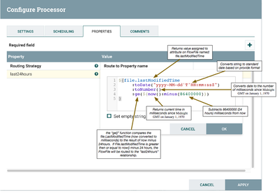

The RouteOnAttribute processor expects that a NiFi expression Language statement is used. If the the evaluation of that EL statement results in a true, then the FlowFile will be routed to the corresponding property name's relationship.
Here is an example that will route FlowFile where the value associated to "file.lastModifiedTime" on the incoming FlowFile falls within the last 24 hours to the "last24hours" relationship:
Here is the full EL statement so you can copy it:
${file.lastModifiedTime:toDate("yyyy-MM-dd'T'HH:mm:ssZ"):toNumber():ge(${now():minus(86400000)})}

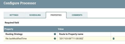

Thanks Matt, i added the processors you recommended, but the Route on attribute processor is compaining about "file.lastmodified validated against '2017-03-08'T'11:00:00Z' is invalid because no Expressions found.

Can you share the NiFi expression language routing rule you created in your RouteOnAttribute processor? The rule must evaluate to "true" before a FlowFile will be routed to that relationship.
New Member
sure, here they are
Master Mentor
@vikash kumar
Are you looking for files where the "file.lastModifiedTime" is exactly 2017-03-08'T'11:00:00Z?
Or are you looking for all files created at that time and newer?
