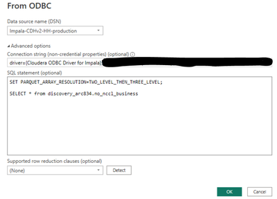

Hello, is there any one know how to set a query option in ODBC connector in Power BI?
Basically, my SQL query contains 2 statements:
(1) Firstly set a query option to allow the array columns in a PARQUET formatted table to be retrieved
SET PARQUET_ARRAY_RESOLUTION=TWO_LEVEL_THEN_THREE_LEVEL
(2) Then query the table. Without the first statement, all the array columns will appear NULL value. Therefore, the first statement is necessary.

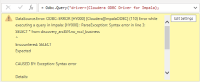

The 2 statements work properly in HUE SQL console with IMPALA SQL. However it results error in ODBC connector, and it seems that ODBC doesn't allow to set a query option: I mean if I remove the query option "SET PARQUET_ARRAY_RESOLUTION=TWO_LEVEL_THEN_THREE_LEVEL;", the "SELECT" statement simply works...
Do you know how to resolve this issue? Thank you in advance!

Hi , I think you need to check with Power BI team whether setting parameters at session level is supported or not. It's an issue/limitation at client side.

Thanks for your suggestion. Power BI uses ODBC connector to retrieve data in Cloudera CDP; from the documentation "In Impala 2.0 and later, you can set query options directly through the JDBC and ODBC interfaces by using the SET statement." (https://impala.apache.org/docs/build/html/topics/impala_query_options.html ), and my IMPALA version is "3.2.0-cdh6.3.4". Therefore, Power BI is supposed to be able to run the query option statement...
However, I will still consult the Power BI end, as you suggested.
