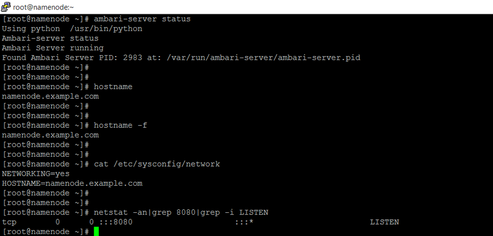

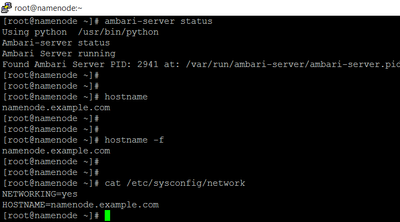

Hi @Geoffrey Shelton Okot ,
Thanks for your response and valuable suggestion(A good starting point is to attach your ambari-server logs). i will take care this in future also.
As you suggest, I have checked ambari port 8080 and it's reachable but still Ambari UI not loading.
So please find my ambari-server logs and ambari-server status in attachments and please guide me to resolve this issue.
