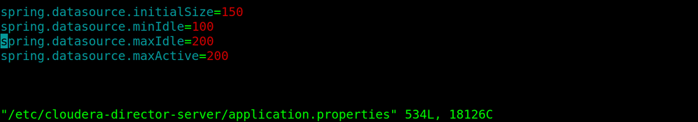

However, I tried the following configuration which should keep 100 connections open at all times:

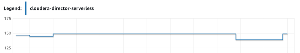

And observed in the cloudwatch monitoring AWS UI that director's connections when shut off dropped the total database connections from 149 to 139 (note that this database is shared by the CM that director spins up which accounts for the other 130ish connections).
When Director was started with the above spring configurations you can see the line return to 149 which indicates that Director only opened 10 connections to the database.
This implies that the defaults for spring.datasource.minIdle and spring.datasource.initialSize are still being used which are 10. Defaults are listed from the link you mentioned: http://tomcat.apache.org/tomcat-7.0-doc/jdbc-pool.html#Common_Attributes
 So it seems Director is not respecting the spring.datasource.* configurations from application.properties. As I don't have access to the source code, is Director loading these things from configurations or hardcoding them somewhere? Apologies in advance if any of my assertions are false.

We're relying on springboot, and are not doing anything special. I notice that in the application.properties embedded in the jar, some of the documented tomcat properties, like testOnBorrow and validationQuery, are being set with a prefix of spring.datasource.tomcat. Based on that stackoverflow answer, I wouldn't expect that to be required for maxActive, but give it a try and let me know if it works.

I can see in the DEBUG logs of HikariConfig that those settings are being respected and the cloudwatch charts show the same.
