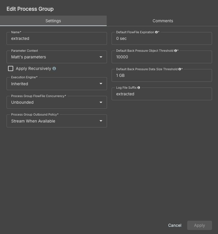

@HoangNguyen
As long as you are running a new enough version of Apache NiFi, you'll have an option with the process group configuration to set a logging suffix.
For each process group you want a separate log file, create a unique suffix.
In above example I used the suffix "extracted".
In my NiFi "logs" directory, I now have a new "nifi-app-extracted.log" file that contains the logging output of every component contained within that process group.

@HoangNguyen
