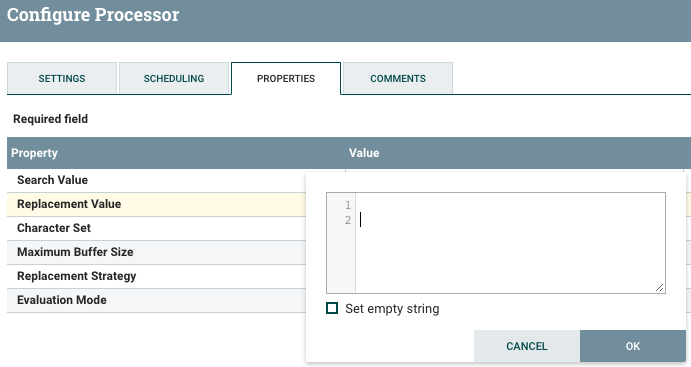

In the "Replacement value" configuration property just hold the <shift> key and hit enter instead of using "\n".
Here is example of what you would see:
This will create the line return you are looking for.
