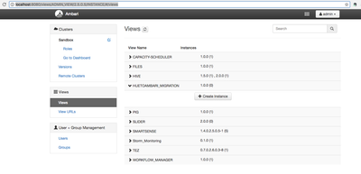

Created on 06-20-2017 03:12 AM - edited 08-17-2019 08:44 PM
Regarding your query: "But cannot find a link to explore HDFS views in Ambari."
You can use the HDFS "File View".
Ambari UI --> "Manage Ambari" --> "Views" --> FILES --> Click on "Create Instance"
Regarding Hue view, You can also find the "HUE TO AMBARI Migration" View in ambari.
Ambari UI --> "Manage Ambari" --> "Views" --> HUETOAMBARI_MIGRATION --> Click on "Create Instance"
For more information please see: https://docs.hortonworks.com/HDPDocuments/Ambari-2.4.2.0/bk_ambari-views/content/creating_a_htv_inst...
The proxy users settings can be set to * means allow every group and request from every host. (or you can use a comma separated list of hostsnames/groups as well in the respective properties)
hadoop.proxyuser.hue.groups=* hadoop.proxyuser.hue.hosts=*
