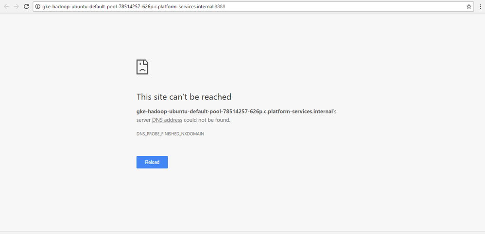

Facing the same issue. Can't connect to the other ports like
8888 - for Hue
50070 - for HDFS
When try to open hue web ui.... its saying "
This site can’t be reached
gke-hadoop-ubuntu-default-pool-78514257-626p.c.platform-services.internal’s server DNS address could not be found.
Please help.

@frankenstein, "server DNS address could not be found." indicates that your configured DNS servers on the browser host cannot resolve your hostname. Make sure gke-hadoop-ubuntu-default-pool-78514257-626p.c.platform-services.internal can be resolved to an IP address on your browser host.

@bgooley "How to resolve the hostname on browser host. Can you please explain the solution in detail."
