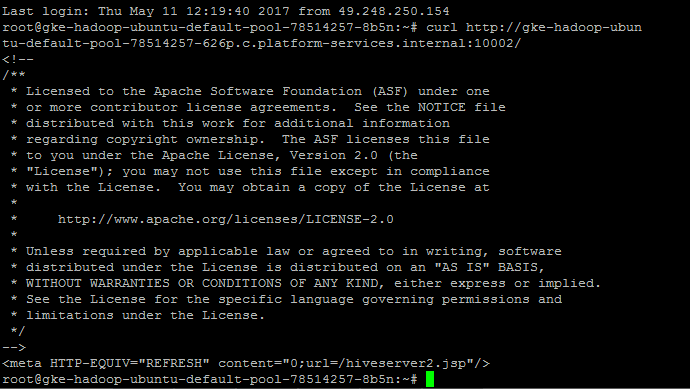

In putty connected to the master instace and performed ping gke-hadoop-ubuntu-default-pool-78514257-626p.c.platform-services.internal ..... its responding. Also performed curl http://gke-hadoop-ubuntu-default-pool-78514257-626p.c.platform-services.internal:10002/ (my hue server is down so tried connecting to hive having 10002 port) got this:
I think in putty its connected but in browser its not resolving the hostname....
