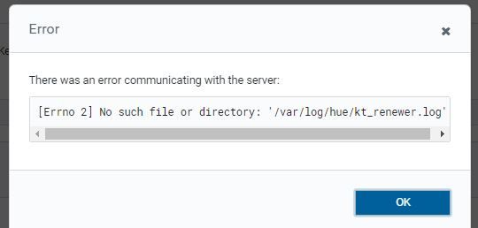

Hello,
I am getting the below error when trying to check logs via CM for Hue Kerberos Ticket Renewer.
CM / CDH - 6.3.3
I checked / /var/log/hue but did not find kt_renewer.log. Appreciate any assistance to fix this.
Thanks
Amn
Created 06-02-2021 03:30 AM
Try creating the file manually on the KT_renewer node with below permission and check again:
-rw-r--r-- 1 hue hue 3712920 Jun 2 15:23 kt_renewer.log
Created on 06-07-2021 05:11 AM - edited 06-07-2021 05:12 AM
Hello @Amn_468,
That's quite strange, as the service should generally look for the log file before starting. The only possibility that I can think of here is that the log file would have been removed manually while the service was running.
Having said that, yes, let's try creating the log file manually with appropriate permissions as suggested by @nthomas, and restart Hue kt_renewer service to see if it is able to write to the newly created file.

Created 06-02-2021 03:42 AM
Hello @Amn_468 ,
Are we setting up Hue KT_renewer for the first time? What is the status of Hue kt_renewer service please?
stderr logs from Hue kt_renewer can give more insights. The below commands can take us to the directory were stderr log is stored.
# export HUE_DIR="/var/run/cloudera-scm-agent/process/`ls -alrt /var/run/cloudera-scm-agent/process | grep hue-KT_RENEWER | tail -1 | awk '{print $9}'`"
# cd $HUE_DIR/logs
