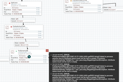

2022-03-30 06:12:42,697 ERROR [Timer-Driven Process Thread-10] o.a.n.p.aws.dynamodb.PutDynamoDB PutDynamoDB[id=d8f73587-017f-1000-2455-aaff9f514cba] Hash key value '' is required for flow file StandardFlowFileRecord[uuid=eaf5b5ae-86c1-44b1-a253-00d44fdbbbff,claim=StandardContentClaim [resourceClaim=StandardResourceClaim[id=1648526788099-3, container=default, section=3], offset=0, length=45235],offset=44777,name=472d9a5c-9b9e-4a2e-91ae-589fbf7a5bec,size=458]
2022
Any help will be much appreciated.

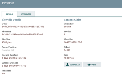

@gizo ,
Is "dynamodb.item.hash.key.value" a property of your flowfile?
Could you show a screenshot of the flowfile properties para with that property?

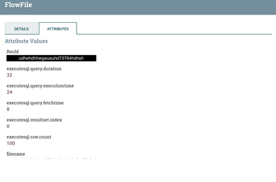

Super Guru
@gizo ,
The JSON you shared is the "content" of the flowfile. The flowfile also have "attributes" metadata. Could you please share a screenshot of that?
André
Was your question answered? Please take some time to click on "Accept as Solution" below this post.
Explorer
see below
Attribute Values
RecId
udhehdhhwgeueuhd73764hdhsh
executesql.query.duration
32
executesql.query.executiontime
24
executesql.query.fetchtime
8
executesql.resultset.index
0
executesql.row.count
100
filename
9c344c33-599e-4dfd-9eda-2006f6df0de5
fragment.count
100
fragment.identifier
da135c88-697d-498f-a5e3-6a45f23eb44a
fragment.index
0
mime.type
application/json
path
segment.original.filename
uuid
34d005dc-09c2-446c-b7aa-963b31e9769a

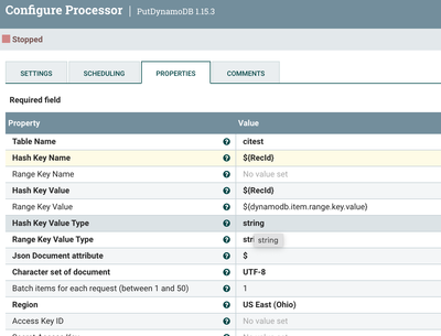

Super Guru
@gizo ,
In your processor you set "Ranger Key Value" to "${dynamodb.item.range.key.value}". This would reference to an attribute in your flowfile, but from the details you provided, there's no such attribute there. This may be the cause of the error.
You must ensure that the attribute exists in the flowfile so that you can reference it in the processor configuration.
