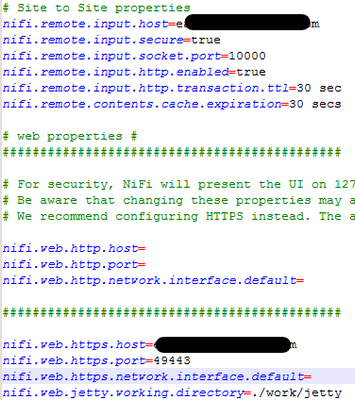

Nifi's configuration is:
Port 10000 is up on Nifi's server and can be accessed from MiniFi's  server...
I'll appreciate your help
